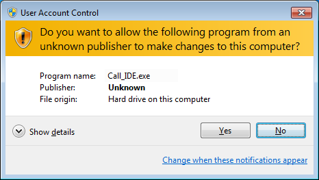

The first time you run Call_IDE.exe, it will detect this automatically by the application and force it to run with administrator rights when the application requires it. So it will show this first message:
Therefore, this application will present several forms of execution and when needs administrator rights, you will have two options:
Allow the application to guide you as being executed, if as a user / administrator or else you must force to be executed from the begining as administrator.

However, if after setting this application and deciding to change the same storage location that the application is run at another time, the application will detect that it is the first time in this new location and will request the configuration again.
2. Allow the application to request authorization to perform task with administrator rights when it finds it necessary. The rest of the options do not require "elevated rights".
After ensuring the use of administrator privileges (if necessary) when replying to this UAC message:

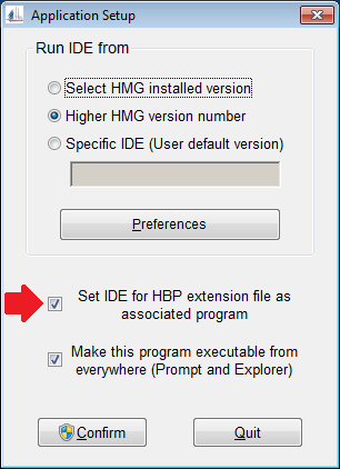

You need to leave the first checkbox option be selected at least, then files with ".hbp" extension will be associated with this application's call and make the appropriate change in your Windows REGISTER:
You must leave the first option of CheckBox selected, at least. Files with a ".hbp" extension will be associated with the call of this application and will make the appropriate change in your Windows REGISTER:
The second CheckBox option is to make sure that the application wherever it is accesses at the command line.
It is recommended to leave it selected.
You can see that the "Confirm" button will have the Shield icon to denote that it is running with administrator rights.
After confirming with the CheckBoxes selected, you will ensure the use of the application.
And these options will always be available if you want to uninstall the IDE support application.
But before confirming, you should also confirm which is the IDE that you will use to use in the version of HMG installed and other preferences that I will explain below.

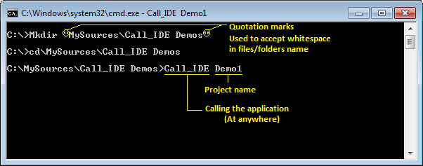

Let's say you want to create a new project on the command line (before you create a new folder for this).
You will type for example:
You do not need to use quotation marks in the parameter unless it contains special characters such as blank space in the file name and folder. Otherwise, containing blank spaces, will be interpreted as multi-parameter arguments.

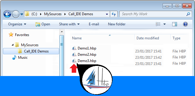

When you confirm the use of Call_IDE and restart your computer, the .hbp file icons will appear like this:

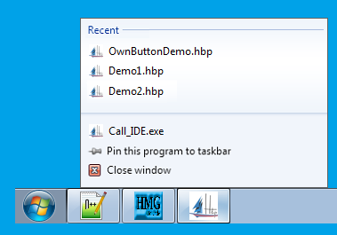

You can access the "Recent" files on the minimized icon in TaskBar:
