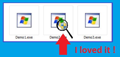

Some procedures require administrator rights and so that it does not go down because of the Windows security system (Windows Vista or later), we use need to elevate privilages even been the user logged as admin.
I've got three examples which can attend these proposes or even serve as examples.
UAC.rar
Source files
(5.93 KiB) Downloaded 309 times
Please note which is in Demo2.rc file contains. ;)
UAC (Exe).rar
Executable files
(3.72 MiB) Downloaded 293 times
I hope you enjoy it and all your contributions are welcome. :P
