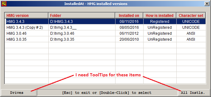

Before posting this new topic I thought a lot if it would consider an HMG bug or some API limitation. That is, I can not enable/display ToolTip in the StatusBar Item, unless the cell size is smaller than the text it displays.
I have just reformulated the StatusBar of the InstalledAt application and I need to display the appropriate ToolTip when positioning on items especially when RAISED style.
I know it looks redundant, but since I use the statusbar click for an action it would also need to show extra help to the user.
Claudio, is this an API limitation or can it be forced to always display the ToolTip in the StatusBar?

Hi Claudio, more one question:
Is would it be workable SET TOOLTIPCUSTOMDRAW CONTROL for STATUSBAR :?:
The StatusBar name control is: STATUSBAR (doesn't it ?) but seems not working with TOOLTIPCUSTOMDRAW :|

srvet_claudio wrote: Tue Jan 10, 2017 11:32 pm I'm sorry Pablo but I do not understand your question.
Hola Claudio, (tudo bem... eso porque nos complicamos en otro idioma...)
Lo que parece ser un BUG y no estoy seguro: si es un bug que puede ser corregido en HMG o si es un limitacion del API que no está permitiendo visualizar siempre los ToolTips que se define en el StatusBar.
DEFINE STATUSBAR FONT "Courier New" SIZE 9 BOLD
	STATUSITEM "[Esc] to exit or [Double-Click] to select",64) TOOLTIP "Click here to change installation mode"
	STATUSITEM "REGISTERED" WIDTH 110 RAISED ACTION MsgInfo("Do something") TOOLTIP "Click here to change installation mode"
END STATUSBAR
Esto deberia funcionar, pero no siempre. Es decir. Lo hace unicamente si uno achica la ventana y los itens del StatusBar quedan cortados... aí si funciona. Pero si la ventana es NOSIZE ai no funciona... :|
Yo quisiera que funcionara siempre, principalmente los itens que son del tipo RAISED (que se asemejan a botones) y que ejecutan algo.
No lo estoy podiendo hacer funcionar. :oops:
Slds
