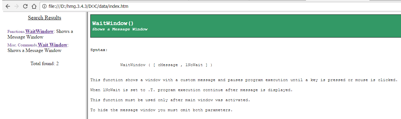

Hi Hazael,
Is it this what are you looking for ?
There are in SAMPLES at:>
D:\hmg.3.4.3\SAMPLES\Controls\WaitWindow\WAIT_WINDOW_1
D:\hmg.3.4.3\SAMPLES\Controls\WaitWindow\WAIT_WINDOW_2
I have posted this other example: viewtopic.php?p=38595#p38595 (with counter)

Bonjour Pablo Cesar,
I think that is what I am looking for but I will have to check the source code and extract only what I need from there.
My intention is to use only that but with GTWVT on Windows to make some messages more "User Friendly" in place of just standard terminal ones...
