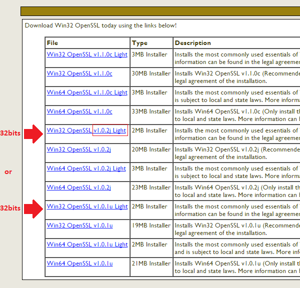

You can download it from: http://slproweb.com/products/Win32OpenSSL.html
If you want to download to use HMG in 64bit, choose the appropriate file.
In this version is available as I said earlier for the HMG version 3.4.3 in 32bits and was downloaded as indicated in the figure below:
Please note that I have not downloaded the first one because it is a more current version and is for the modified functions of Harbour (Viktor version, not the one we use).
