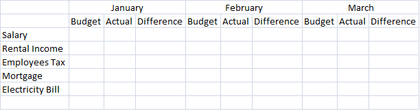

As we know, this is not possible in our actual grid control.
MultiLine Grid Header.png (7.82 KiB) Viewed 5064 times
Then reading at little bit more at: Multi-line (merged) datagridview header I saw this that it could interesting to be read:
Difference between datagridview and listview control :o
Whos knows this could let us to reach another proper results ? It could ? :?
