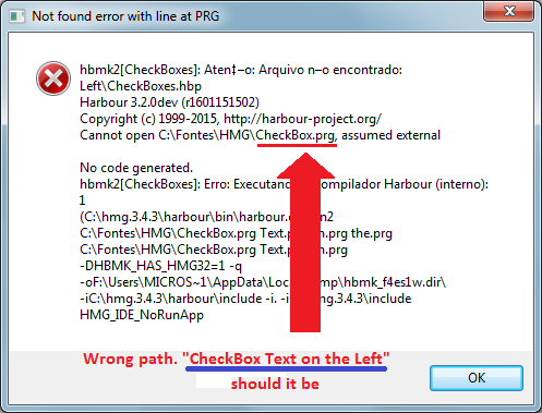

At the time it's coming this message error:
Then I've checked what IDE it's passing as parameters and I saw the fullpath and project was not quoted... :|
Is it possible to make our IDE in the next release to insert quotes in it ?
If you do this, all projects even with espaces in its names will be posible for building by IDE also.

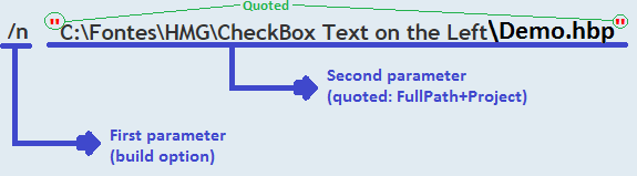

When the IDE be corrected (in case), it would pass parameter like this:
These suggestions are TOTALLY backward compatible with any project.
