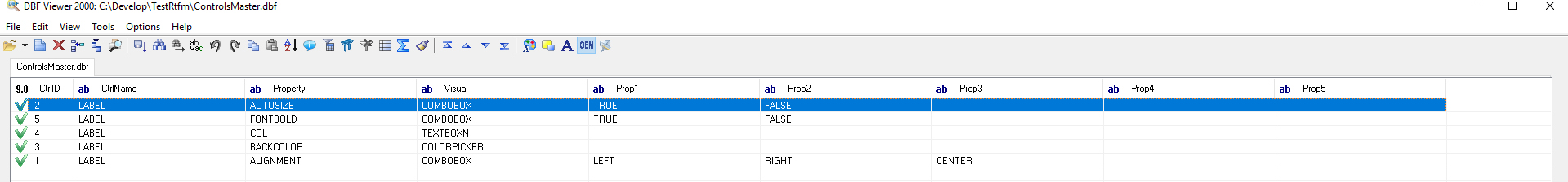

I was thinking of a way to have the control properties displayed dynamically, without the need of changing the code everytime we need to add a property or a new control.Here is my idea so far and i would love your input and your critic on it :
We make two dbf files(or anything else to be honest, SQL tables, ini files etc...)
First file we call it ControlsMaster.dbf and it has the following structure:
1st Field : CtrlID - Numeric - Size 3 - It contains the ID of a specific property of a specific control
2nd Field: CtrlName - Character - Size 30 - The name of the control
3rd Field: Property - Character - Size 30 - The name of the property
4th Field: Visual - Character - Size 30 - The name of the control that will visually be displayed on the rtfm form.
5th Field: Prop1 - Character - Size 30 - The 1st value that the property can get
6th Field: Prop1 - Character - Size 30 - The 2nd value that the property can get
7th Field: Prop1 - Character - Size 30 - The 3rd value that the property can get
8th Field: Prop1 - Character - Size 30 - The 4th value that the property can get
9th Field: Prop1 - Character - Size 30 - The 5th value that the property can get

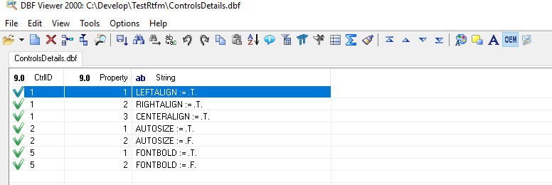

Second file we call it ControlsDetails.dbf and it has the following structure:
1st Field :CtrlId - Numeric - Size 2 - It contains the ID of a specific property of a specific control
2nd Field: Property - Numeric - Size 3 - The number of the property
3rd Field: String - Character - Size 50 - The string that will be inserted in the form.
So let me give you an example of a user who wants to change the alignemnt property of a label :
The program will show a combobox with the following values: Left-Right-Center.
Lets say that the user chooses the Right alignment. On the 1st table we find the all the controls with the name LABEl at first. Then we search for the ALIGNMENT property and we get two numbers. The CtrlID which is 1 in our case and the property that was changed which is 2 in our case(RIGHT).
Now we go to the 2nd table and search for CtrlID==1.AND. Property==2. That returns the string "RIGHTALIGN := .T." which we can now use to change the property and/or put it in the fmg file.
I hope i explained it quite ok.This way we can add controls or properties at any time with no need of messing with the code.
I would love to hear your ideas and opinions on that.
Thanks
Vagelis
