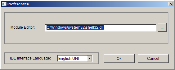

Hi Claudio,
When we have not any source editor installed yet in PC or when we just installed but not rebooted yet and we go to Tools/Preference/Module Editor it's coming this wrongly path (pls see picture below):
Most probably IDE function do not found in Windows register the .prg associated.
In case you are interested to see how I detect, I'm attaching a demo for your appreciation.
Local cEditor:=CheckExt("prg") // HKEY_CLASSES_ROOT\.PRG
Local cNPP:=""
If Empty(cEditor)
   cNPP:=IsNotepadPlusPlus()
   If !Empty(cNPP)
      If MsgYesNo("Do you want to set Notepad++ as source default editor ?","Notepad++ is already installed")
	     cEditor:=cNPP
	  Endif
   Endif
Endif
If Empty(cEditor)
   MsgStop("Source editor <Not installed> !")
Else
   MsgInfo(cEditor,"Editor for prg files")
Endif

Added later:
This example doesn't sets anything at current Windows Register. So, it's totally for info and IDE setup that proposes only.

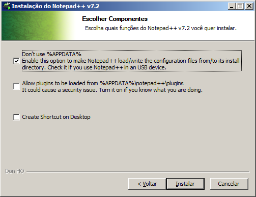

I surely prefer to have my Notepad++ installed not like as:
Because this way installed it's for USB proposes and do not save all the prgs that were open Notepad exiting program.
I prefer to keep all open files recorded in its own Notepad capacities not to cut resources...
