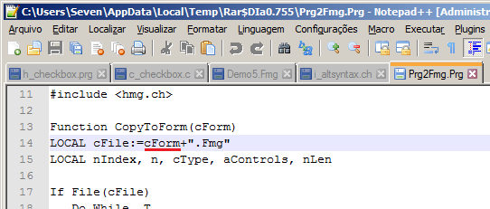

Sorry, I am deeply in sad at this moment, I hope to receive a good new for Claudio stay.
I tried to start already but not conditions at moment, all is in my mind. But I believe that we'll not need to check syntax of control. Once the control is working properly with the source code already compiled and approved by the builder.
The text be generated will be quite similar or let say strictly same than fmg files done by HMG/IDE.
I think at begining we'll just call a function Prg2Fmg to generate fmg file with same name of WINDOW/form.
Thanks Dragan for your interest.
