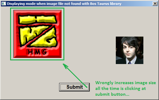

Hi Claudio,
I'm sorry to distrubing again. But now after my last experience in sources of my "What displays when no image available?" topic and I've to appoint this observation:
When we use SET CONTROL <Image_Control_Name> OF <Form_Name> CLIENTEDGE, image control size (width and height) is increasing due edge's size. is it normal ?
I test with all internal function to get image's size and figures returns wrong by the reason of image's container are bigger... :o
I've tried with these 4 options:
BT_BitmapWidth (hBitmap)/BT_BitmapHeight (hBitmap)
  • GetProperty(cForm,cControl,"Width")/GetProperty(cForm,cControl,"Height")
  • GetWindowWidth()/GetWindowHeight()
  • _HMG_SYSDATA [ 31 ]/_HMG_SYSDATA [ 32 ]
These all options returns width and height sizes which should be mostly same size for the respective image control. But disappointingly this not happen, always size is wrongly increasing. If you cut of CLIENTEDGE of control, then works ok.
IMHO this EDGE's size should it be not be considered as part of control's size.
In short:
  1. Is it normal to increase the image size when EDGE style is choosen ?
  2. Is it possible the EDGE's properties not being part as control's size and not interering int width/height of image control ? (not increasing)

Claudio, have you seen this my question ?
In the attached executable file you can see image increading size.
Re: Image Get and Set Properties
Yes is normal that the size increase. You need make the following step:
// nOldStyle := HMG_ChangeWindowStyle ( hWnd, [ nAddStyle ], [ nRemoveStyle ], [ lExStyle ], [ lRedrawWindow ] )
1) remove edge style if exist
old := HMG_ChangeWindowStyle ( hwnd, NIL, HB_bitOR (WS_EX_CLIENTEDGE, WS_EX_STATICEDGE, WS_EX_WINDOWEDGE), .T. )
2) get the image size
3) restore the old style
HMG_ChangeWindowStyle ( hwnd, old, NIL, .T. )
