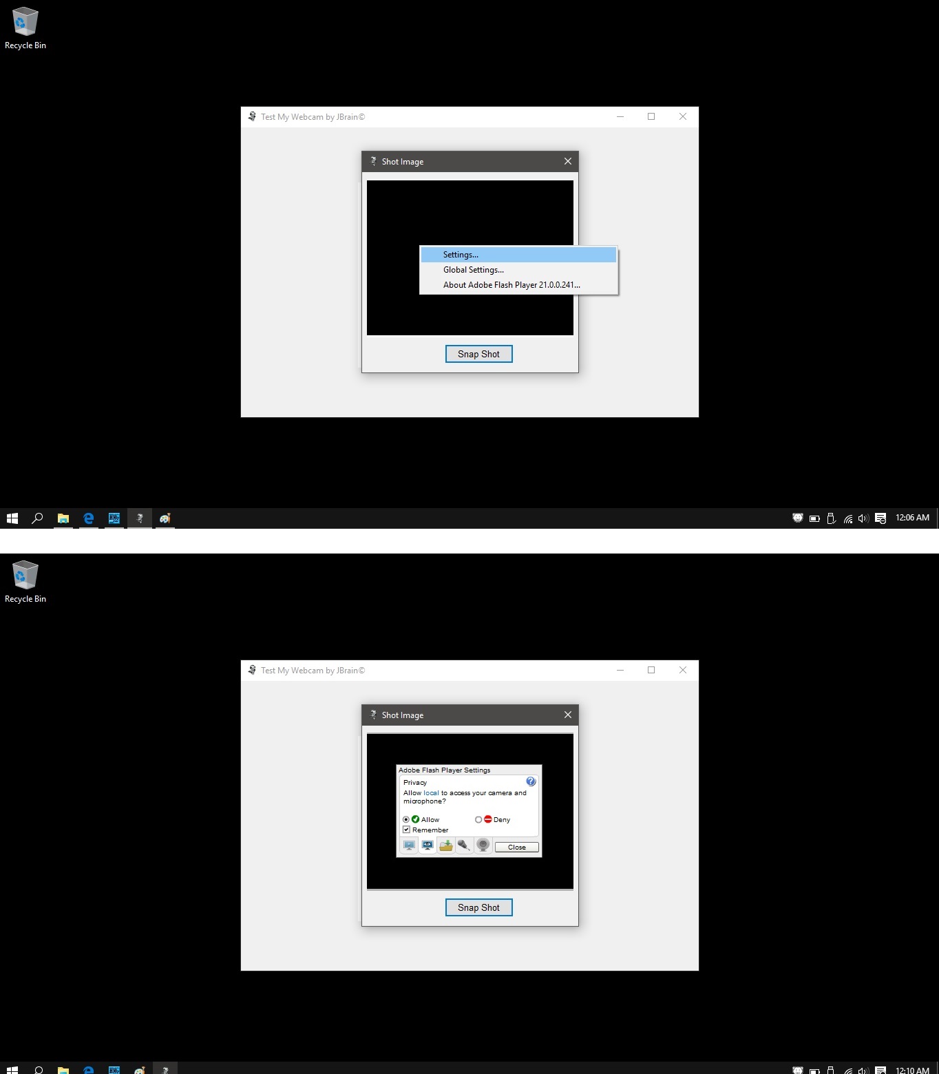

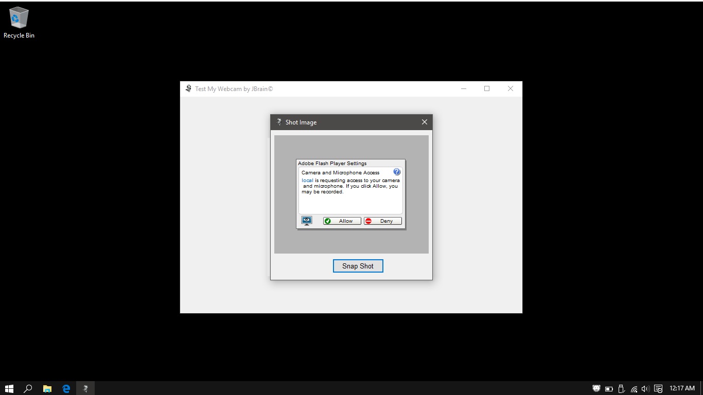

Make sure you have webcam attached to your pc and working properly Instructions:
Compile and run the program
Click Allow
If you want not to ask again every time you run the program right click to the moving object then check the Remember
Click Allow

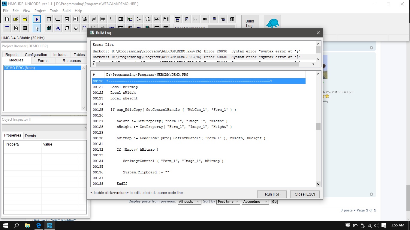

hi mr filatov. I compiled your program and it is what happened.
Kindly send the necessary library for this function. tnx and more power.
