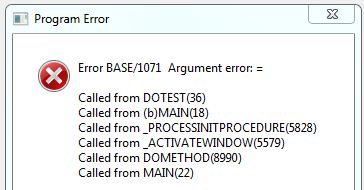

   Test comparing arrays
PROC Main()
    DEFINE WINDOW frmMiniFMan ;
        ROW 0 ;
        COL 0 ;
        WIDTH 550 ;
        HEIGHT 470 ;
        TITLE 'Compare Arrays' ;
    		ON INIT DoTest();
        MAIN
    END WINDOW // MAIN
    frmMiniFMan.Center()
    frmMiniFMan.Activate()
    ON KEY ESCAPE ACTION frmMiniFMan.Release
RETU // CompArrs.Main()
*-._.-._.-._.-._.-._.-._.-._.-._.-._.-._.-._.-._-._.-._.-._.-._.-._.-._.-._.-._.-._.-._.-._.-._
PROC DoTest()
   aArry1 := { 1, 2, 3, 4 }
   aArry2 := { 1, 2, 3, 4 }
*  MsgDebug( IF( aArry1 = aArry2, "Equal", "Not egual" ) ) // Argument error
   MsgDebug( IF( aArry1 == aArry2, "Equal", "Not egual" ) ) // Not Equal
RETU // DoTest()
Result of using simple equal sign for compare arrays
