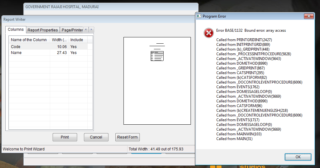

[ SOLVED ] ==> The issue is some thing to do with reports.cfg generated by print grid(hfcl\Source\GridPrint.prg). I have deleted the file and re-run my report and it went successfully.
Error Message
Called from PRINTGRIDINIT(2426)
\HMG\343\hfcl\Source\GridPrint.prg - piece of code causes the issue
printgrid.header2.value := iif(HMG_LEN(alltrim(header2)) == 0,gridprintdata[2,2],header2)
in turn referring this data ...
ln#2394 get gridprintdata[2] section windowname+"_"+gridname entry "gridprintdata2"
I'm developing a small application in HMG 3.4.3 Unicode Version. Suddenly i'm encountering BASE/1132 error in GRID PRINT. All my report grid report is throwing the same error. I've attached the screen shot. I searched at forum and google groups but could not find the solution. Tried multiple options but ended with the same result.
Grid has very small array ( 5 rows 3 cols ) Only.
Can any one assist ? Thanks in Advance.
