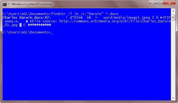

Re: Programmers editor with...?
Maybe this...
https://www.powergrep.com/manual/commandline.html
o with
findstr /l /n /c:"Darwin" *.docx ...... and somehow open the editor
o with
