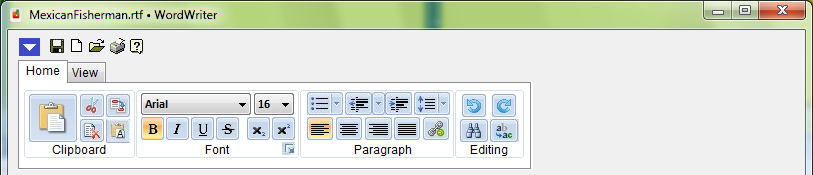

Below is the WordWriter ribbon interface.

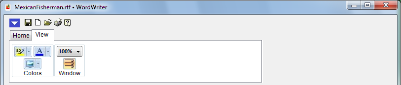

Below is the View tab of WordWriter.
