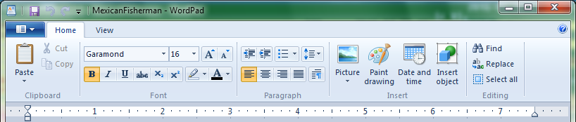

WordWriter is based on the quasi-ribbon interface in MiniWriter, which is in SAMPLES\Applications\MiniWriter\.
Below is a screenshot of the quasi-ribbon interface in MiniWriter.
The above interface is similar to that of WordPad in Windows 7, below.
