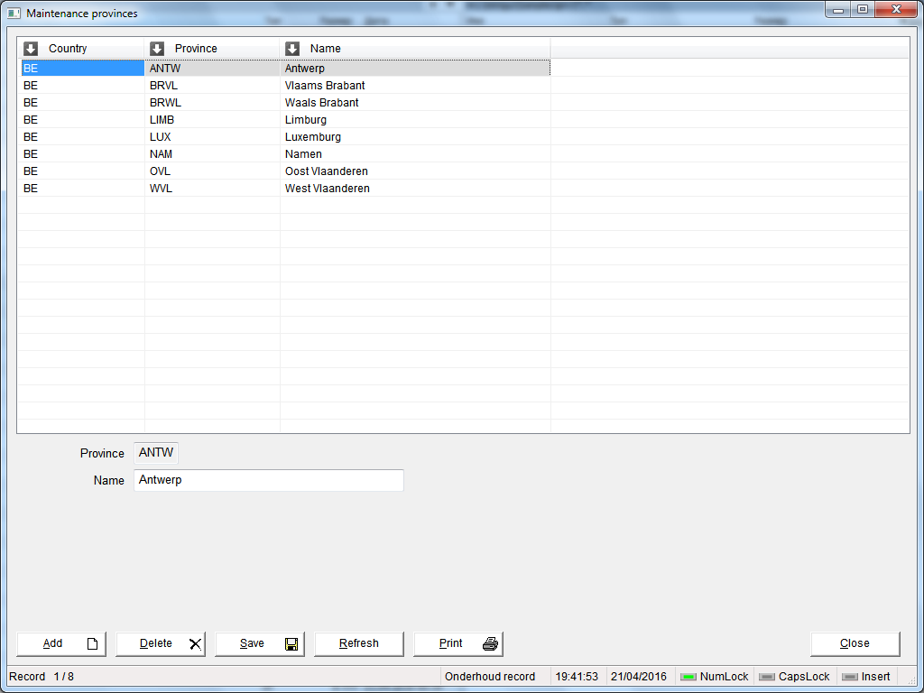

I've adapted this example to a recent build of Minigui Extended Edition 16.04 with a small improvements
Please take a look for an attached code with the proposed modifications.
- prv-ex.zip
- Source code
- (873.12 KiB) Downloaded 325 times
- Updated look of application
- prv.png (68.71 KiB) Viewed 5855 times
