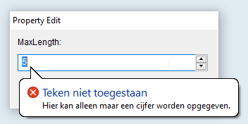

A minor detail.
I use Windows 10 Home and installed HMG 3.4.2.
The default value of 'MaxLength' in a TextBox is Nil. I can modify the MaxLength to a numeric value. But I can't reset it to Nil.
When I try typing Nil, it seems only numeric values are allowed. Shouldn't Nil be allowed too ?
Kind regards, Marc
Kind regards, Marc

Re: MaxLength and Nil value
This is IDE issue ?
Dear Dr. Claudio Soto
I do not know if it is an HMG or an IDE or other problem . I cannot tell the difference. I do not know who or where to report such matters. I assumed that this forum was the right place . I'm sorry if I 'm not in the right place.
Kinds regards, Marc
Kinds regards, Marc

Hi Marc,TopsMarc wrote:Dear Dr. Claudio Soto
Kinds regards, Marc
Yes, this is the right place for: questions, report bugs, make suggestions, code contribution, etc.

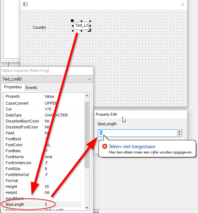

Hi Dr. Claudio Soto,
Thank you for the clarification of the 3 HMG components.
The error message occurs when I design the screen, not when I execute my application.
I created a TextBox. The MaxLength property initially was Nil.
I set the MaxLength property to 3. Then I want to reset it to Nil, but that is not allowed. I cannot enter the word Nil in the Property Edit window, only numerics are allowed. Shouldn't it be possible to reset it to Nil ?
I included a new print screen.
Kinds regards, Marc
Kinds regards, Marc
Thanks Marc, now I understand the problem.
I will check.
Solved the problem, now if you put zero is equivalent to Nil value.TopsMarc wrote:Hi Dr. Claudio Soto,
Kinds regards, Marc
