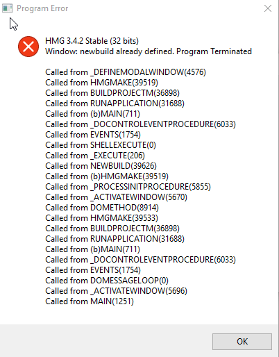

I use Windows 10 and installed HMG.3.4.2.
When I click once on the arrow to compile and run a program, there is no problem.
But when I click 2 or 3 times quickly after each other when compiling has not finished yet, I get a program error "Window : newbuild already defined. Program Terminated". HMG-IDE shuts down abnormally. I will have to start up HMG-IDE again, and open my project again. Maybe in a next release the designer can catch the error and not terminate abnormally, and keep the project open ? Is this the right place for such a suggestion ?

I will check.

Thank you dr. Claudio Soto. Kind regards, Marc.

I fixed!
