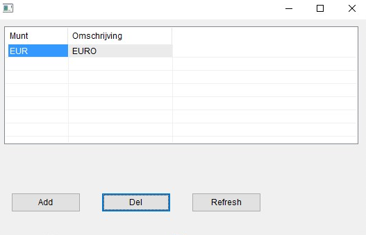

Open the project VM.hbp. When I run the project and click 'articles' and 'valuta', my database VM.DBF is shown. I have 3 records
The current record is 'BEF'. I press the DEL button to delete the current record. There are 2 records left, 'EUR' and 'NLG'. Ok so far. (see IMG 2)
The current record is now 'EUR'. I press the DEL button.
Instead of the NLG-record, I see the EUR-record. (see IMG 3)
I don't understand why I don't see the NLG-record now.
And when I press the 'Refresh' button, again the EUR record is shown, and not the NLG record.
What am I doing wrong ? Or could there be a bug in the .save and .delete and .refresh method ?
If you need more information, please ask me.

- IMG 2.png (33.37 KiB) Viewed 7707 times
- IMG 3.png (26.68 KiB) Viewed 7707 times

Instead of deleting a record in a grid with the delete and save method that doesn't seem to work (and I don't know why not) ...
Win_KR.KR_Grid_KR.Delete
Win_KR.KR_Grid_KR.Save
I tried it now like this ...
VM->(DBGoto ( Win_KR.KR_Grid_KR.RecNo ))
VM->(DBDelete())
VM->(DBSkip())
IF VM->(EOF())
VM->(DBGobottom())
Win_KR.KR_Grid_KR.RecNo := VM->(recno())
Win_KR.KR_Grid_KR.Refresh
Win_KR.KR_Grid_KR.Setfocus
It didn't work either.
When the BEF record is deleted, recno() becomes 2, and the current record in the grid becomes EUR. Fine so far.
When the EUR record is deleted, recno() becomes 3, but the current record in the grid doesn't become NLG, but it is again EUR, and NLG is not shown in the grid. I don't get that at all.
And the refresh button ...
also again shows EUR instead of NLG. Why is that ?
it is so frustrating not being able to use the grid without such errors, and I can't figure out what I am doing wrong. Or is this a serious bug ?
