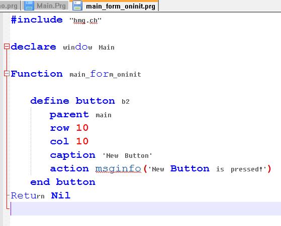

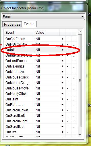

As you have said, it is simple. Let me show you.
Double Click on the '+' as shown below, to add a module to main form init event.

Rathinagiri perfect its now working!
What I think I missed was:
1. I needed to "Create a New Function Module" on the OnInit() event of the main window.
2. Put the code in the corresponding new .prg as you indicated.
EDIT: I think I was close adding code in different events but perhaps the IDE needed to initiate\manage it as you indicated. I hope that helps anyone else having the same issue.

Re: Add Control at Runtime in IDE Env
I am happy hat it worked.
Since GUI is event driven, we have to write the code to the appropriate event as a module. It can be inside the same prg or by a new prg as created by IDE on double clicking the '+' sign.
