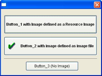

:) Hi to all,
I've detected a problem using HMGIde 2.8.6f (if really this is a problem...)
Assuming that I've created a Form and inserted two buttons: Button_1 and Button_2.
In Button_1 I've defined PICTURE property as a resource file (image01),
corresponding to existing file ok02.bmp.
In Button_2 I've defined PICTURE property as a file ( ok02.bmp)
After Build, when the app runs, only Button_2 shows a picture.
For better understanding, see attached sample.
Best regards,
Salamandra[
Button_image.rar
(532.85 KiB) Downloaded 1033 times
Re: HMGIde 2.8.6f - Problem with PICTURE property in Button
Hi Salamandra
Simply change :
line to
in your resource.

:) Hi esguici,
esgici wrote: Simply change :
line to
in your resource.
Oh my God !!! .... I am really embarrassed.... :oops: :oops: :oops: :oops:
I wrote resource files at least 25000 times...
I don't imagine how I could commit this grotesque error...
Sorry, Sorry and Sorry again.
Thank you very much for your help.
Best Regards,
Salamandra
