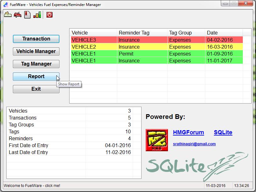

I am happy to share yet another project of mine with you all.
I have named this project as 'FuelWare' which can be used to track expenses related to vehicles in an organization like fuel, insurance, permit and other. I am making the documentation and once it is over, I will share that with you. I am sure the screens are self explanatory.
The project is based on SQLite database. It comes with a sample database. If you want to enter in a fresh database, please rename/delete the file named 'fuelwaredb.sqlite'. A new file in this name will be created.

Now it is time for some screenshots: :)
Main Screen

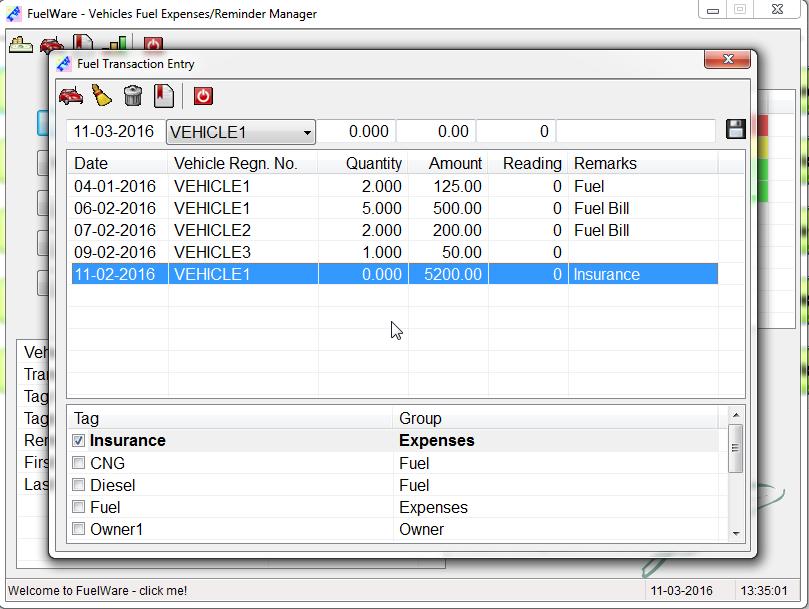

Transaction Entry Screen

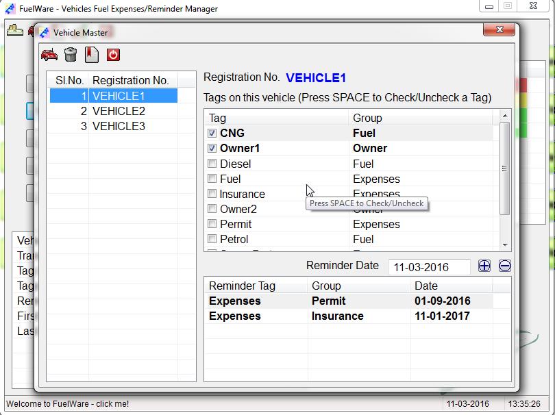

Vehicle Management Screen

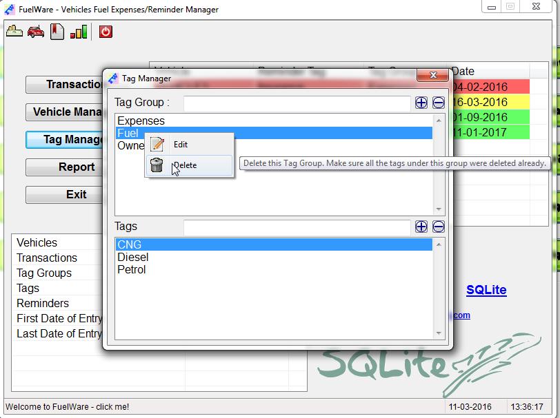

Tag Management Screen

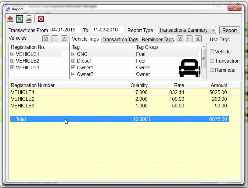

Report Screen

I have not tried it but I did like that so I think we should add this information, state flown kilometer when full, if you need to take into account the average consumption
Re: FuelWare
Posted: Fri Mar 11, 2016 10:39 am
dragancesu wrote:Great looks
In this software I am giving provision to find out the mileage in a different way. Whenever possible, we can just enter the odometer reading (there is a separate field for entering the odometer reading in the transaction entry between amount and remarks). This will help in a later stage to find out the average mileage of a vehicle.
This can be tracked for any particular expense also (like battery or tyre replacement).
Please comment about my idea also.
