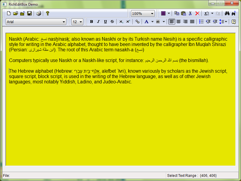

Perhaps I'm missing something, but the RichEditBox control already supports right-to-left writing. It uses a standard Windows rich edit box, which has supported right-to-left scripts for many years. All the standard Windows controls support right-to-left scripts. See the attached file for a screen shot of the current Rich Edit Demo with Arabic and Hebrew text.

There is no need to add anything. This feature is already in the Rich Edit Demo. If you copy right-to-left text into the document, it will display properly, and you can edit it as you expect. That's what I did to get the image I posted in my last message. The cursor automatically goes from right to left when it encounters text in a right-to-left script. This is true of almost all controls in Windows.
But you cannot TYPE such text. Are you asking for a feature that would let you type this text? Do you want to press Latin keys and get Arabic or Hebrew output? That is a significant change. I have done it for Devanagari, the alphabet of Sanskrit and Hindi. I think it would not be too hard to make a similar program for Arabic or Hebrew. I don't know Arabic or Hebrew, so it would not be good for me to attempt this.
