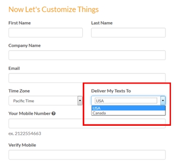

Re: Execute File with long command line string
Hola Russ
Solo funciona para USA y CANADA ?
Hi Russ
Only it works for USA and Canada?
