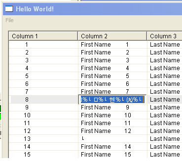

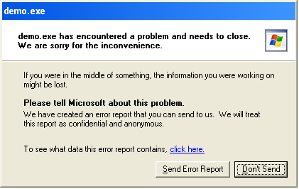

Eduardo is correct, there is some problem in WinXP
Even we select Col-6 Memo of example Grid-25 program program quit with error as per screen attached
When we try to edit Col-2 edit box filled with junk character as per screen
