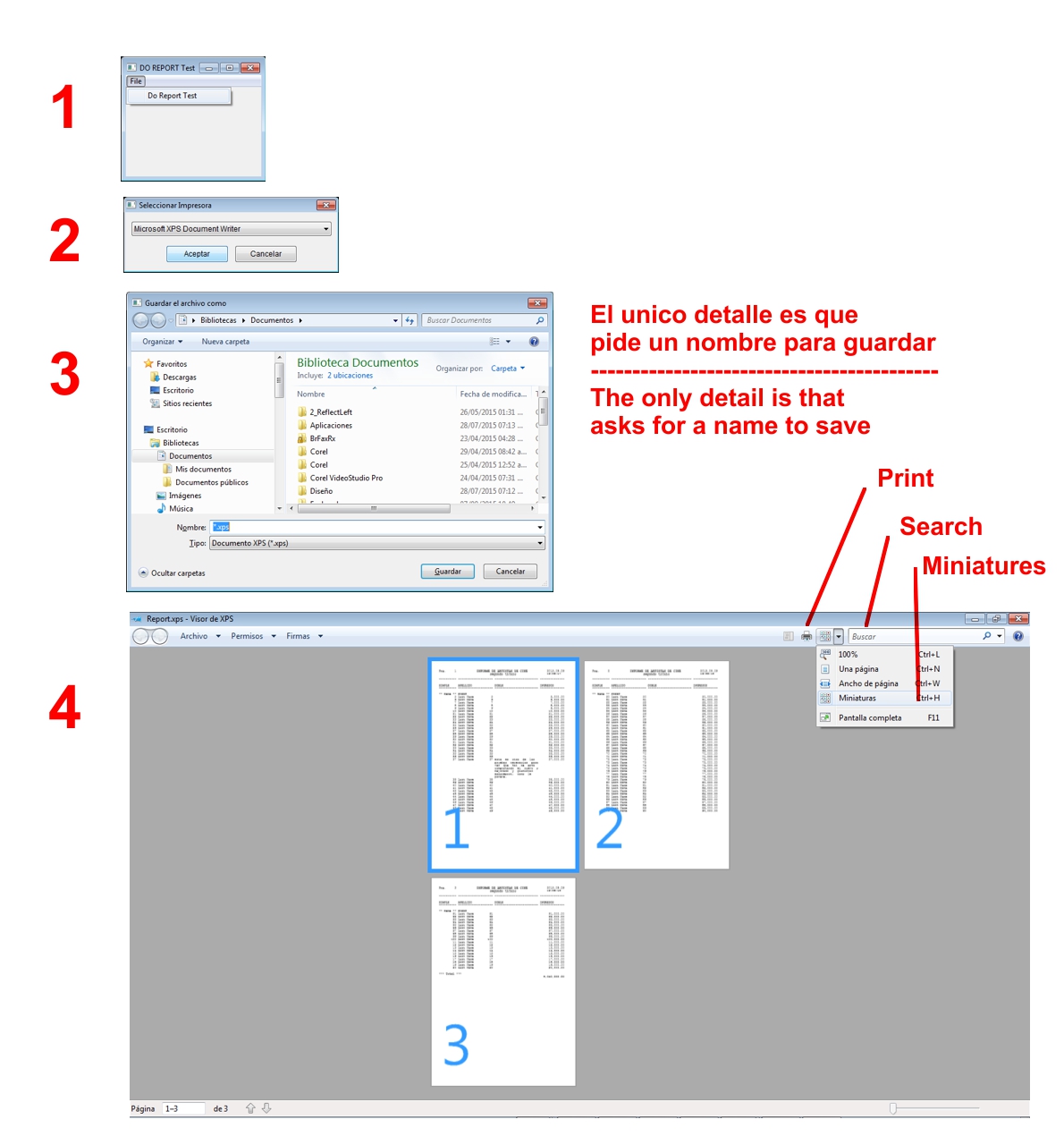

Re: Read text file no allow edits
Posted: Thu Sep 10, 2015 1:25 am
by andyglezl
Ok
Aqui les dejo una solución (de muchas) basada en el ejemplo de DO REPORT
OK
Here 'a solution (of many) based on the example of DO REPORT
DoReport2XPS.zip
(2.73 KiB) Downloaded 428 times
Step 2: Microsoft XPS Document Writer
