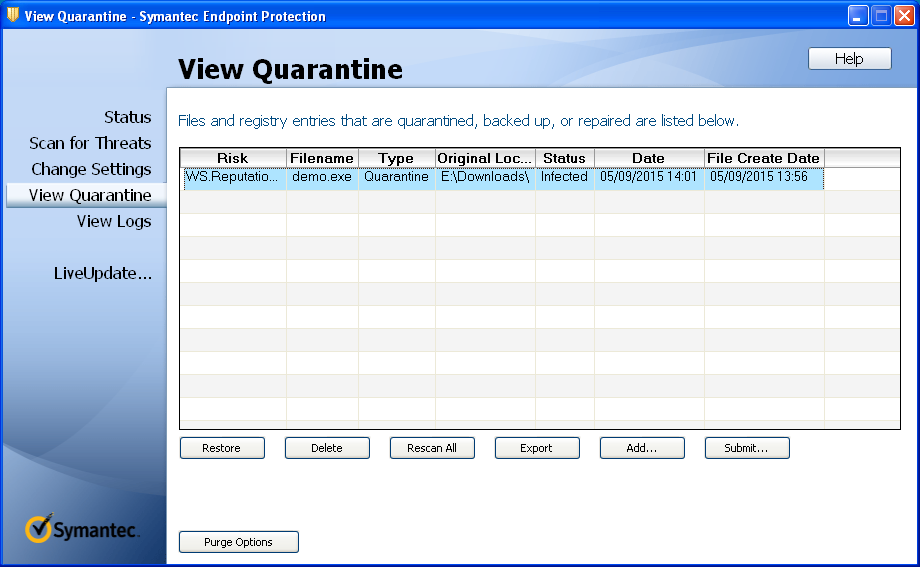

Re: Status of source code changes suggested in November 2014
My antivirus Symantec found risk Quarined Demo.exekcarmody wrote:I think it must be a false positive. I have run this demo since last November. AVG has never reported a problem with it, and I have never seen any symptoms of any problems. It is constructed from a modified version of HMG, with all modified source code in the folders around it.Carlos Britos wrote:Maybe is a false positive, but Avast report infection DRep and the file Demo.exe is deleted
- untitled.PNG (66.29 KiB) Viewed 11108 times
