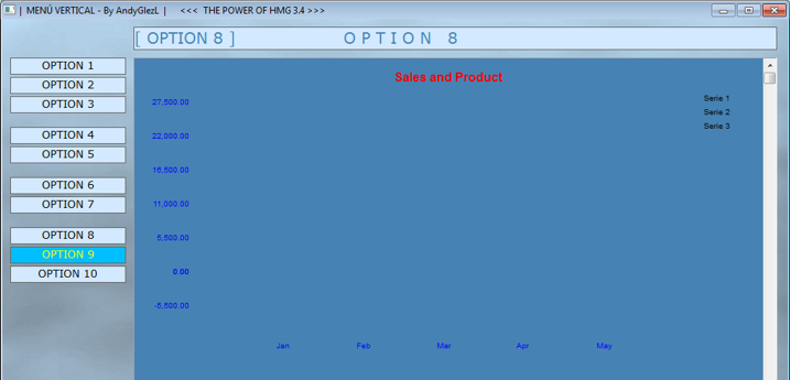

ERASE WINDOW command does not delete the graph titles
Hola
El comando ERASE WINDOW no borra los titulos de la grafica, creo que ya se habia dado una solucion
pero en esta version (3.4) sigue sin aplicarse. Quizas ya este implementada en la 3.41 ?
Hello
The ERASE WINDOW command does not delete the graph titles, I think they had already given a solution
but in this version (3.4) remains unimplemented. It may already be implemented in the 3.41?

Re: ERASE WINDOW command does not delete the graph titles
Thanks Esgici that was the solution.

IMHO, drawing graph on the window itself is an outdated HMG graphics functionality.
The permanent solution for drawing graph is using the ultimate and versatile Bos Taurus library.
I have tried to convert the existing draw graph function ( only BAR type and not 3D) using BT library and saved the graph in a bitmap file. That bitmap can be used to show or print.
May be we can extend this to all other types and we have a NEW graph functionality to save the graph easily to a bitmap in HMG.
Rathinagiri wrote:IMHO, drawing graph on the window itself is an outdated HMG graphics functionality.
Thanks Mr. Rathinagiri :)
I couldn't understand lines commented by old style "&&" sign instead of "//" :?
Is there a special meaning / purpose of that coding style :?:
Regards :D
EduardoLuis, Serge, Marek wrote:..."HMG-ENCICLOPEDIA"...
Hi friends, please don't exaggerate :oops:
I'm simply a HMG student :P
Viva HMG :D
I don't know the difference. But NotePad++ comments the lines we select and press Control+Q with &&.
