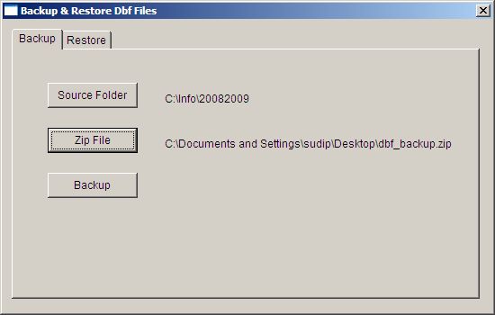

Hi All,
I was experimenting how to zip and unzip files with HMG.
I found that existing COMPRESS and UNCOMPRESS don't fulfill what I want.
So, I "learned" to use low level hb_ commands. Moreover I used the GetSaveFileName() and
GetOpenFileName() functions (Win32 functions if I am not wrong) here.
(Thank you Rathi. I got the "courage" from you to use low level functions.)
Please downlowd
BackRest.zip
(3.57 KiB) Downloaded 1033 times
. Compile and run.
And please tell me how to upgrade this project.
It is very useful for learning HMG.
With best regards.
Sudip
