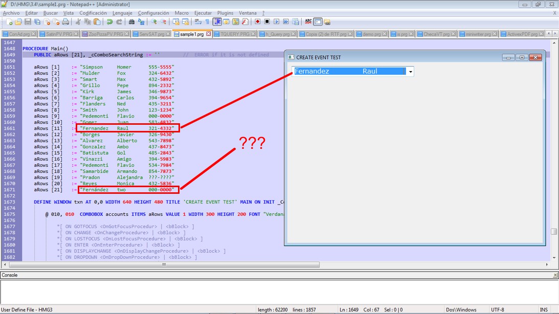

Re: "OnKey Event" SAME AS "OnDblClick Event"
Hola Rathinagiri
Tratando de entender tu ejemplo con el "Create Event", hice lo siguiente: (pero no se si así es como deba funcionar)
* Siempre encuentra el primer registro "fer" pero existen 2
* Puse "ON INIT _ComboBoxAnywhereSearchInit( .f. )" para hacer la llamada a esta función // Pero da ERROR si pongo .T.
* Si pongo la propiedad SORT, me da ERROR
* En que momento se hace la llamada a la "funcion _ComboBoxAnywhereSearchClose( )"
Hello Rathinagiri
Trying to understand your example with the "Create Event", I did the following: (but not if this is how it should work)
* Always find the first record "fer" but there are two
* Put "ON INIT _ComboBoxAnywhereSearchInit (.f.)" To make the call to this function // But fails if I put .T.
* If you get the property SORT gives me ERROR
* At what point it is the call to "_ComboBoxAnywhereSearchClose() function"

								exit
						next i
					if .not. lFound
						playbeep()
				else // down key search for next
					lFound := .f.
					for i := nLineNo + 1 to getproperty( cWindowName, cComboName, 'ITEMCOUNT' )
						// first check in the starting chars...
						if  hmg_upper( _cComboSearchString ) == hb_uleft( hmg_upper( getproperty( cWindowName, cComboName, 'ITEM', i ) ), hmg_len( _cComboSearchString ) )
							lFound := .t.
							setproperty( cWindowName, cComboName, 'VALUE', i )
							exit
					next i
					if .not. lFound // anywhere searching...
							if  HB_UAT( hmg_upper( _cComboSearchString ), hmg_upper( getproperty( cWindowName, cComboName, 'ITEM', i ) )  ) > 0
								lFound := .t.
								exit
						next i
					if .not. lFound
						playbeep()
				return 1
		case nVKDown == VK_ESCAPE
			HMG_CleanLastVirtualKeyDown()
			_cComboSearchString := ''
			_ComboBoxAnywhereSearchUpdate( cWindowName )
			return 1
		case nVKDown ==  VK_RIGHT .or. nVKDown ==  VK_LEFT .or. nVKDown ==  VK_HOME .or. nVKDown ==  VK_END
			return nil
		case EventIsMouseMessage ()
//			  _cComboSearchString := ''
			return nil
	otherwise
		IF nEventMsg <> WM_CHAR
			Return Nil   // enable processing the current message
		_cComboSearchString := _cComboSearchString + ch
	endcase
	lFound := .f.
	for i := 1 to getproperty( cWindowName, cComboName, 'ITEMCOUNT' )
			lFound := .t.
			exit
	next i
				lFound := .t.
				exit
		next i
	if .not. lFound
		playbeep()
		_cComboSearchString := HB_ULEFT( _cComboSearchString, max( 0, ( HMG_Len( _cComboSearchString ) - 1 ) ) )
RETURN 1
FUNCTION _ComboBoxAnywhereSearchUpdate( cWindowName )
	if iscontroldefined( _combolabel, &cWindowName )
		setproperty( cWindowName, '_combolabel', 'VALUE', _cComboSearchString )
RETURN nil
