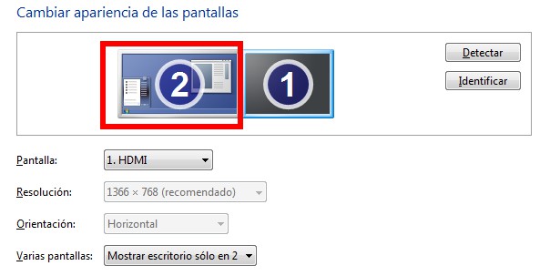

Habrá alguna forma de programar para poder abrir una ventana directamente en un segundo monitor por medio de nuestro programa ?
quizá... (o algo )
Hello
There will be some form of program to open a window on a second monitor directly through our program?
maybe ... (or something)
DEFINE WINDOW FormDetalle AT 0,0 WIDTH 1024 HEIGHT 560 TITLE " | NUEVA NOTA |" CHILD NOSIZE NOMAXIMIZE MONITOR 2
Second Monitor.jpg (43.95 KiB) Viewed 17225 times

IMHO, the only way is to set coordinates of opened window

Recerda que el debe tener la propiedad de pantalla extendida el segundo monitor.
si tu monitor esta en una resolucion de 1024x768
crea un form cajero ubicado en 0,0 y otro form usuario en 1025,0.
sino la otra solucion seria utilizar 2 aplicaciones comunicadas con mensajes entre si...

It's hard to determine where second monitor "starts".
I'm working on two monitors: first 19" has resolution 1280x1024 and second 22" with resolution 1920x1080.
Both of them work in the same time...

mol wrote:It's hard to determine where second monitor "starts".
1° monitor
GetDesktopHeight() --> nDesktopHeight
GetDesktopWidth() --> nDesktopWidth
position 0 , 0 to nDesktopWidth, nDesktopHeight
2°monitor
GetDesktopHeight() --> nDesktopHeight2
GetDesktopWidth() --> nDesktopWidth2
position 0, nDesktopHeight + 1 .or. 2 to nDesktopWidth2, nDesktopHeight2 - 1 .or. 2
hope not wrong---
NOTE : forgiveness. Monitor extension widths are added ...
what remains are the high fixed monitors and these do not add up.

Daniel,
IMHO this is not the right way because GetDesktopHeight() and GetDesktopWidth() will return with maximum screen size.
Considering fix (not changeable) size in Monitor 1 by Mark said:
mol wrote:I'm working on two monitors: first 19" has resolution 1280x1024
I believed should it be like this:
1st Monitor:
nHeight1 := 1280
nWidth1 := 1024
2nd Monitor:
nHeight2 := ( GetDesktopHeight() - nHeight1 )
nWidth2 := ( GetDesktopWidth() - nWidth1 )
My suggestion: nHeight1 and nWidth1, could it be variable receiving this parameters from line command or thru saved in INI file.

Pablo : te falto un poco de lectura..
aclare que desde 0,0 to GetDesktopHeight(), GetDesktopWidth() para el monitor 1...
despues desde 0. GetDesktopHeight() + 1 to ( GetDesktopHeight() - nHeight1 ), nWidth2
la fila 0 en los 2 monitores es igual, cambia o puede cambiar el alto de los 2 monitores seria un error RESTAR ya que el monitor 1 pude ser mas chico que el monitor 2...
