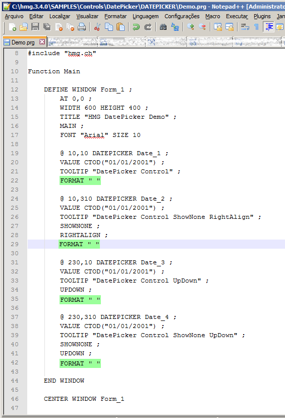

By taking an example of C:\hmg.3.4.0\SAMPLES\Controls\DatePicker\DATEPICKER\Demo.prg by adding FORMAT " " (note a space in quoted) you will get this result:
In code language... on this example you just do this:

For who wish to see HMG demo in SAMPLES (based on C:\hmg.3.4.0\SAMPLES\Controls\DatePicker\DATEPICKER\Demo.prg), see this:
 * Copyright 2002 Roberto Lopez <mail.box.hmg@gmail.com>
 * http://www.hmgforum.com//
Set Century On
Set Date British
	DEFINE WINDOW Form_1 ;
		WIDTH 600 HEIGHT 400 ;
		TITLE "HMG DatePicker Demo" ;
		MAIN ;
		FONT "Arial" SIZE 10
		@ 10,10 DATEPICKER Date_1 ;
                VALUE CTOD("  /  /    ") ;
		TOOLTIP "DatePicker Control" ;
		ON CHANGE SetProperty ( ThisWindow.Name, This.Name, "FORMAT", GetDateFormat() );
		FORMAT "  "
		@ 10,310 DATEPICKER Date_2 ;
		VALUE CTOD("01/01/2001") ;
		TOOLTIP "DatePicker Control ShowNone RightAlign" ;
		SHOWNONE ;
		RIGHTALIGN ;
		FORMAT " "
		@ 230,10 DATEPICKER Date_3 ;
		TOOLTIP "DatePicker Control UpDown" ;
		UPDOWN ;
		ON GOTFOCUS SetProperty ( ThisWindow.Name, This.Name, "FORMAT", GetDateFormat() );
		FORMAT " "
		@ 230,310 DATEPICKER Date_4 ;
		TOOLTIP "DatePicker Control ShowNone UpDown" ;
		SHOWNONE ;
		UPDOWN ;
		FORMAT " "
	CENTER WINDOW Form_1
	ACTIVATE WINDOW Form_1
