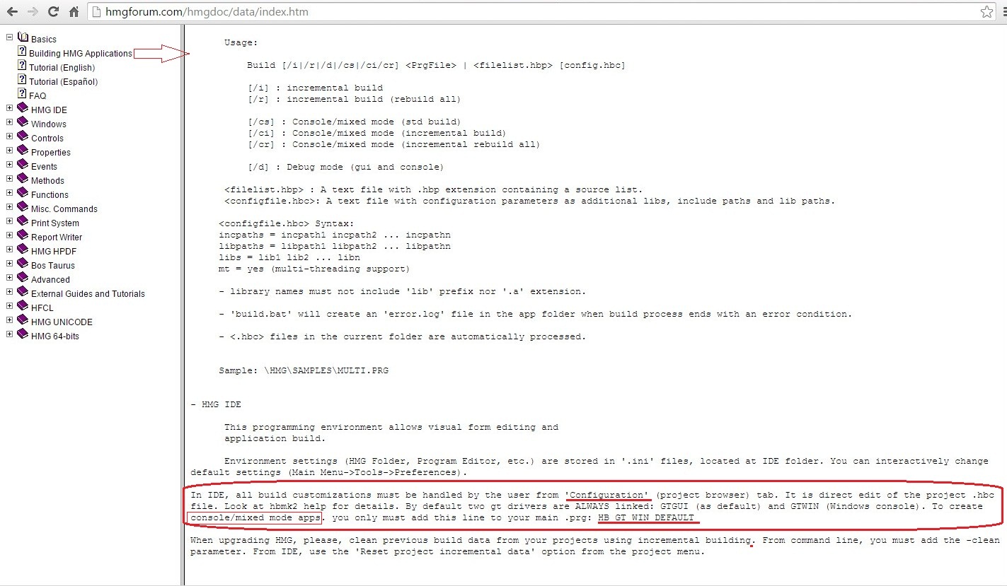

Re: HMG 3.0.46 - CORRECTLY SET MODE CONSOLE
Build note from HMG Help
Hola a Todos :
Actualmente ese texto es diferente en la Referencia de HMG 3.4.0 pero el nuevo esta mas optimizado para una facil compresion...
gracias a todos por ese granito de arena...
Hi Everyone:
Currently the text is different in Reference HMG 3.4.0 but the new is more optimized for easy compression ...
thank you all for that bit
danielmaximiliano wrote:Hi Everyone:
Good remembered Daniel !!
But the main point is you have a appointed the correct DOC even for HMG 3.0.46 and higher versions. Because all those parameters were not valid for long time and hmgdoc where corrected by this main reason.
RIGHT:
WRONG:
You can read this topic for long time:
viewtopic.php?f=8&t=3997&p=37448#p37448
