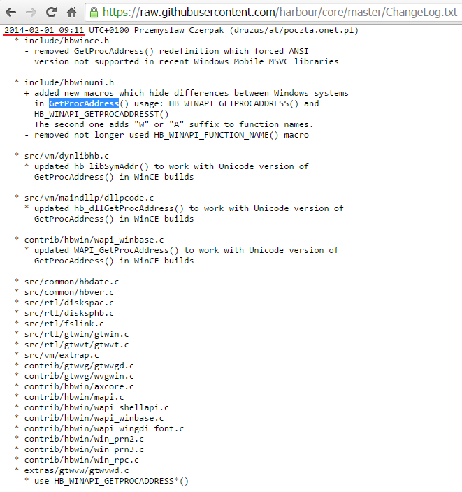

I think I was wrong when I said that. Reading carefully Harbour's ChangeLog there are some changing regarding GetProcAddress and there is function call at HB_DynaCall for DYNACALL1.
So probably some internal Harbour's routines was modified...

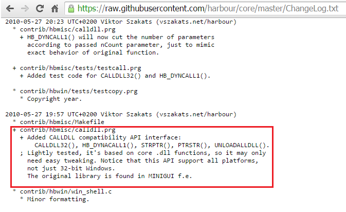

CALLDLL32 This function has originated by Minigui and Viktor Szakats adapted to Harbour in hbmisc contrib on 2010-05-27.
I guess some changes happen in MinGW C Preprocessor, because at HMG 3.4.0 is not working properly... :(
Also I guess the main problem could it be when was modified GetProcAddress function to adjust for ANSI/UNICODE or 32/64bits proposes. ( See at Harbour's ChangeLog at 2014-02-01 09:11 UTC+0100 Przemyslaw Czerpak )
So, in that way, I will check if we have to fix our library changing GetProcAddress by GetProcAddressW or GetProcAddressA according when it been in ANSI or UNICODE. But this it should be review when at updated Harbour version in HMG pack.

What is happining now recently is at this last HMG version (3.4.0) and as any software with new release is subjected to make post corrections/adjustment specially in our case as Harbour is starting work in UNICODE as we have already started. And I said that I considered unfair your most important POV is because these CALLDLL32(), HB_DYNACALL1(), STRPTR(), PTRSTR(), UNLOADALLDLL() are Minigui creation and it has been served as referance for Harbour. I believe these functions were not exist before in Harbour, right ?.
What I have not seen clearly is why Viktor has used same functions names and what did not kept retrocompatibility at these lasted Harbour versions (nearly 3.2.0dev r1501091819 with HMG 3.4.0). But this is not HMG fault, IMHO.

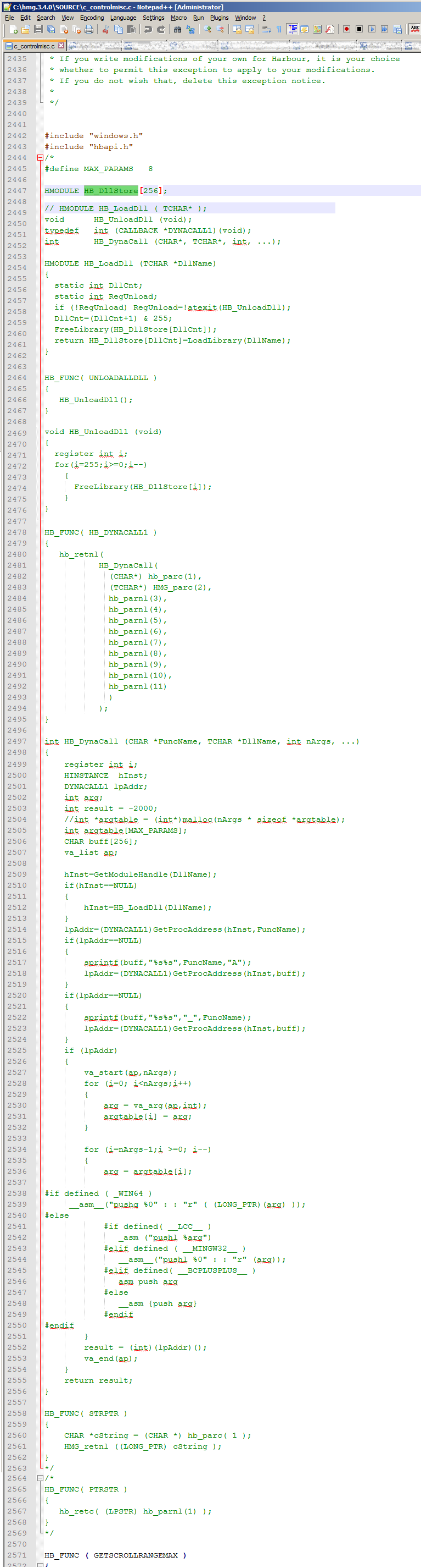

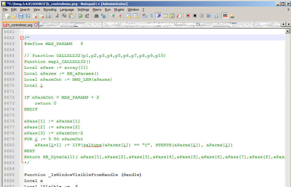

Provisional solution (unofficial) for the current version HMG 3.4.0:
To edit C:\hmg.3.4.0\SOURCE\h_controlmisc.prg and C:\hmg.3.4.0\SOURCE\c_controlmisc.c and execute buildlib.bat.
This is what I've done and worked perfectly. :D

Pablo César wrote:Provisional solution (unofficial) for the current version HMG 3.4.0:
Done, thanks Pablo.
