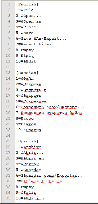

  2. To be created a single INI file containing its text of each languages. Like this (for example):
    And this INI file we can named as "Languages.lng"

Nice idea Pablo.
Instead of having numbered identifiers we can use the named identifiers. By that way, there won't be any confusion in using them inside prg.

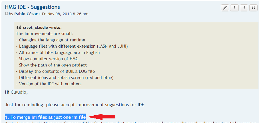

Anyway, we would start with languages regarding texts and messages for our library only and Claudio (because we have not access of IDE sources :cry: ) try to unify all these INI files for our IDE ( editor.ini, hmg.ini, language_UNI.ini and UseBuildBat.ini ). This last indication it was made at long time ago at:
Is always good to know Claudio and Rathi opinions and indications, so then we could begin to untie the language within the source code.
