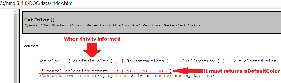

In everyone its the same. Upto this last HMG version, GetColor when be cancelled is returning {NIL,NIL,NIL} value.
(See at my first attached picture in this topic, what hmgdoc says)
I think is still very practical and do not need special treatment for any retro-compatibility (I guess) if will return as Default color (of course when have it been informed).
In case you want to continue checking return when is Nil and in that case you want to atribute different color than the current one, you could it have two options:
  1. By GetColor() (without any parameter) then it could still return as {NIL,NIL,NIL}
  2. By GetColor(<YourDefaultColor>)
By the second option at your old source codes, certaily will never be attended, because a DefaultColor was defined.
Of course if any modification will be approved in this suggested way.

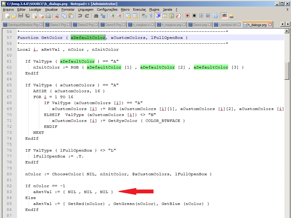

Here is source code for GetColor function at HMG library:
At indicated line by red arrow, I propose to be replaced by:
	  If ValType ( aDefaultColor ) == "A"
	     aRetVal := aDefaultColor
	  Else
	     aRetVal := { NIL , NIL , NIL }
	  Endif
This changing will work with { NIL , NIL , NIL } return when be cancelled by user and not be informed aDefaultColor parameter for who wants to use for checking return. But also will work without runtime error when aDefaultColor is informed and user cancel the color selecting.
