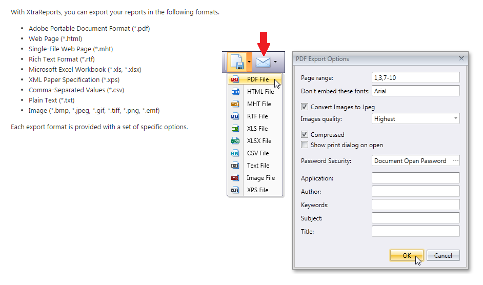

I was looking examples for send by email in Print Preview and I saw this:
I found interesting options and way to export in "Save as" for our Print Preview, nice ones too.
I'm imagining this option for send by email, should be easier to execute file for sending by default email engine.

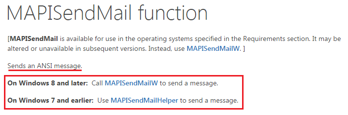

I think the Print Preview function need to add a button to send us an email sending data with CdoSys in windows.
another feature is specified here: https://msdn.microsoft.com/en-us/librar ... 85%29.aspx

Seems very interesting what you said, but for me this is hard to understand.
You are the guy in this matter, I guess.
But this article is showing there differances between OS version ( MAPISendMailHelper / MAPISendMailW ) and also seems a solution in ANSI.
How about UNICODE ? Or this will be not concerned case for our last HMG version ?

MAPISendMail() does not support UTF-8, only Ansi. If you need to send Unicode data, you have to use MAPISendMailHelper() on Windows 7 and earlier, or MAPISendMailW() on Windows 8 and later. This is clearly stated in the MAPISendMail() documentation.
