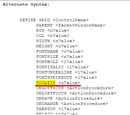

Seems is not so strange to see demmands about ToolTips in each Column of Grid at internet.
I do not know if is hard or could affect any speed at our Grid. But as we know there is only one ToolTip for all the Grid.
I think would it be good for this property to accept an ARRAY and handle it according the number of column.
What do you think ?

Sorry to disagree, but IMHO seems much easier to implement ToolTip for Grids by an ARRAY than making multine headers and cells in Grids.
Imaging to trigger _SetToolTip function to display in each column (by This.CellColIndex for example) and specific Tooltip according column can also be changed on runtime. What it could allow diferent ToolTip according any conditional situation.
