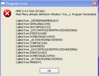

I have a problem when I want to redefine the main menu with the last hmg version 3.4.0. I have this error message :
When using version 3.0.46 everything was working right. Any idea on how to solve that?

Hi Chris,
Since HMG 3.1.2 version there is a new Define/Release at runtime Main / Context / Notify / DropDown Menu
You can see in this MENU_Dynamic_Demo for download or at C:\hmg.3.4.0\SAMPLES\Controls\Menu\MENU_Dynamic_Demo you can find it to analize how disable before make your new atributions.

Thanks a lot for this fast answer!
It solves the problem but it complicates the program. It was more simple before. But there were certainly very good reasons to do that.

You can simply release main menu and create it again (from hmg 3.1.2)
if IsMainMenuDefined("MainFormName")
RELEASE MAIN MENU OF MainFormName
MsgStop("Main Menu is not defined!")
Redefine main menu
