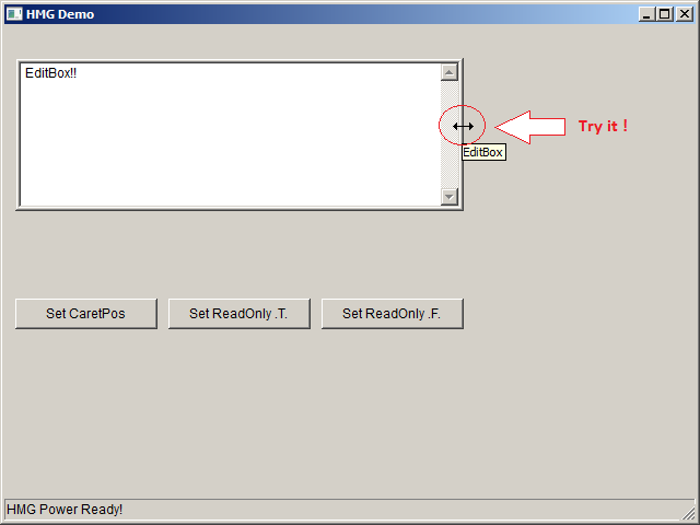

Hi HDT and others,
How about to add an option in EditBox to accept SizeProcedure and let to final users to resize this control :?:
I have experienced adding WS_SIZEBOX at INITEDITBOX function in c_editbox.c and you can test this attached executable file and give your opinion if you want:
Sometimes users would need to size EditControl and at that time could be actioned an UDF (User Defined Function) which could allow to resize form or execute others routines following the EditBox resizing. ;)
demo_WS_SIZEBOX.rar
Executable demo file
(1.12 MiB) Downloaded 334 times
All for improvings that would all enjoyed it ! :D

Posted: Mon Feb 16, 2015 1:36 pm
Thank you Marek for your interest.
mol wrote:But, It should be possibility to limit size by programmer, I think. (Maybe it's done?)
Yes I also believe this could it be possible if EditControl could allow to insert something like this:
ON SIZE <{SizeProcedure}> as new property of control (new style).
I also was looking also for this:
Its name is RESIZE CONTROL.
But I do not know how to do it. All these demmands need for HDT be approved and better implement.
EditBox - Resizable
Posted: Mon Feb 16, 2015 1:41 pm
It is also posible to limit which can be allow for sizing side.
Thru WM_NCHITTEST can know it.
https://msdn.microsoft.com/en-us/librar ... s.85).aspx
Re: EditBox - Resizable
Posted: Mon Feb 16, 2015 3:24 pm
by srvet_claudio
In this example you move and resize a Grid control:
#define WS_CAPTION 0x00C00000
#define WS_SIZEBOX 0x00040000
HMG_ChangeWindowStyle ( Form_1.Grid_1.Handle, WS_CAPTION + WS_SIZEBOX, NIL, .F., .T. )
EditBox - Resizable
Posted: Mon Feb 16, 2015 3:53 pm
Thanks Claudio,
So, you mean that no need to mess in HMG source code to get EditBox as Resizable with:
HMG_ChangeWindowStyle ( Form_1.Edit_1.Handle, WS_SIZEBOX, NIL, .F., .T. )
