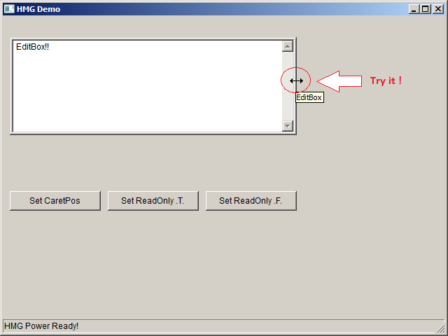

Hi HDT and others,
How about to add an option in EditBox to accept SizeProcedure and let to final users to resize this control
I have experienced adding WS_SIZEBOX at INITEDITBOX function in c_editbox.c and you can test this attached executable file and give your opinion if you want:
Sometimes users would need to size EditControl and at that time could be actioned an UDF (User Defined Function) which could allow to resize form or execute others routines following the EditBox resizing.

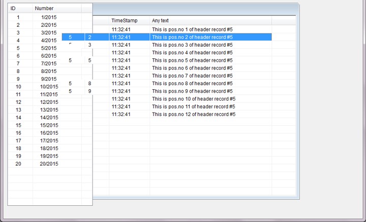

In this example you move and resize a Grid control:
#define WS_CAPTION 0x00C00000
#define WS_SIZEBOX 0x00040000
HMG_ChangeWindowStyle ( Form_1.Grid_1.Handle, WS_CAPTION + WS_SIZEBOX, NIL, .F., .T. )

Thanks Claudio,
So, you mean that no need to mess in HMG source code to get EditBox as Resizable with:
HMG_ChangeWindowStyle ( Form_1.Edit_1.Handle, WS_SIZEBOX, NIL, .F., .T. )
But what about with:
