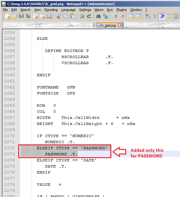

Hi HDT (HMG Development Team) again,
Is it posible to add another new property for TEXTBOX at GRID when is defined at COLUMNCONTROLS ?
For COLUMNCONTROLS:
We use to declare like this:
  • aCtrl_07 := { 'TEXTBOX','CHARACTER' }
  • aCtrl_08 := { 'TEXTBOX','DATE' }
  • aCtrl_09 := { 'TEXTBOX','NUMERIC','99999999' }
The suggested is to accept the string "PASSWORD" at second parameter, option as CTYPE normally used to define if is NUMERIC, CHARACTER or DATE, then the TEXTBOX will act as PASSWORD new property:
Then we could make like this: aCtrl_10 := { 'TEXTBOX', "PASSWORD" }
This is new implementation will allow to put passwords at specific column of GRID and this is optional too.
For this propose, need to only correct at _HMG_GRIDINPLACEEDIT function in h_grid.prg (around line # 1072).
I rebuilded lib and realized a test in C:\hmg.3.4.0\SAMPLES\Controls\Grid\GRID_25\demo.prg, changing textbox:
The results was partial, for editing is displaying well as password:
But for navigating is not displaying as a password. I'll be need a help from HDT, probably Dr. Claudio could offer a solution. At least could be displayed something like this: <Password> (not showing its value).
I attached executable file for your appreciation:

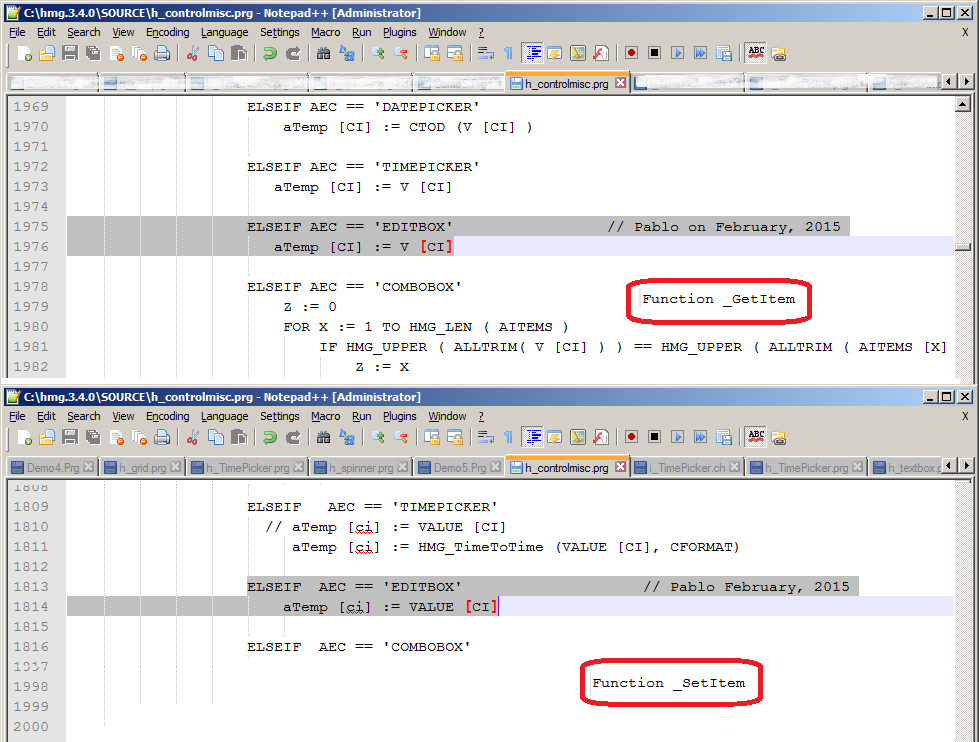

Actually EDITBOX for ColumnControl only works for Grid in ROWSOURCE (with database) !! :o
And even not been a grid for ROWSOURCE doesn't accept any value ! :shock:
To HDT: In order to work EDITBOX at any type, is it posible to fix _SetItem and _GetItem at h_controlmisc.prg as follows ?
This will allow to use EditBox when is also not RowSource.

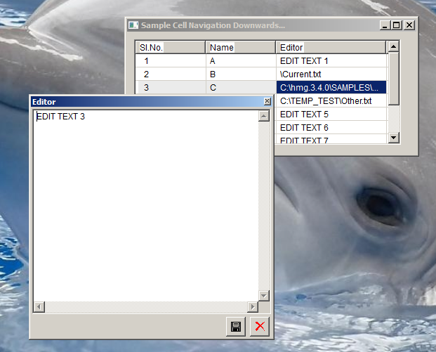

Taking this opportunity to ask for more this feature also:
When EditBox at Grid, we could define independent files to be edited.
In the column we could put the file names (with path or not for current folder).
Then the system will make a previous checking, it can be interpreted if this strings are being compose a file name or simple string to be edited.
In the source code proposed, we change following at h_grid.prg:
  • New parameter for _HMG_GRIDINPLACEEDITOK procedure.
    PROCEDURE _HMG_GRIDINPLACEEDITOK( IDX, CI, RI, AEC, ALABELS, CTYPE, CINPUTMASK, CFORMAT, CVA, aReturnValues, cValCell )

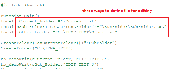

You can use this code to make tests (before and after changing HMG library):
 * HMG Data-Bound Grid Demo
 * (c) 2010 Roberto Lopez
 * Revised by Pablo César Arrascaeta
 * Added EditBox in static cell and files for edition
Function Main()
Local cCurrent_Folder:="\Current.txt"
Local cSub_Folder:=GetCurrentFolder()+"\SubFolder\SubFolder.txt"
Local cOther_Folder:="C:\TEMP_TEST\Other.txt"
CreateFolder(GetCurrentFolder()+"\SubFolder")
CreateFolder("C:\TEMP_TEST")
hb_MemoWrit(cCurrent_Folder,"EDIT TEXT 2")
hb_MemoWrit(cSub_Folder,"EDIT TEXT 3")
hb_MemoWrit(cOther_Folder,"EDIT TEXT 4")

This demo is working in static cell and also three different ways to define file name for edition.
See that files must be define stating with "\" or "C:\"...
Please remember to remove C:\TEMP_TEST folder and SubFolder where this demo will be executed.
