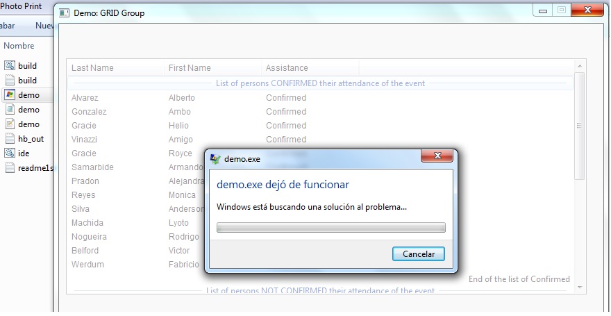

In the example Grid_Groups if you click on the cell that makes the division of the groups the program stops working.

The grid group demo crashes when you click on the title of the group.
Windows 7 - Aero Enabled.

Javier Tovar wrote:In the example Grid_Groups if you click on the cell that makes the division of the groups the program stops working.
Demo C:\hmg.3.4.0\SAMPLES\Controls\Grid\Grid_Groups crashes when is clicking inside the red rectangle.
luisvasquezcl wrote:The grid group demo crashes when you click on the title of the group.
