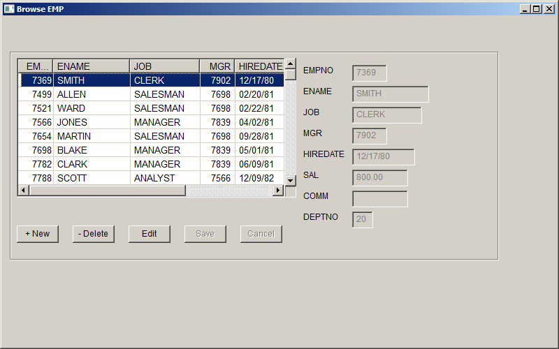

Posted: Wed Jan 14, 2015 1:59 pm
by dragancesu
Today I did something that I needed, a simple generator forms with BROWSE control
Choose dbf and you will create a program, just compile
Simple, without images
Quick Browse Form

Thank, Dragan, but a small observatión when in a table there area other field types than "C","N","D", like ( Memo, Logical) the generator use the same type that the last field,
to be more clear:
Table_1: Name (C), Pos(N"),Date_("D"),Comen("Memo")
the quick generator makes:
Name "C"
Pos "N"
Date "D"
Comen "D"
Plese try whith this table \hmg\SAMPLES\Applications\CONTACTOS\CONTACTOS.dbf
Regards, Ed

Re: Quick Browse Form
Posted: Fri Jan 16, 2015 4:43 pm
by Steed
This error is caused by that I report in previus post, here, because the generartor takes in account only 3 types of fields ("D","N","C",) and when the field have other kind of data like Memo or logical, the generator use last type that have the previus field
