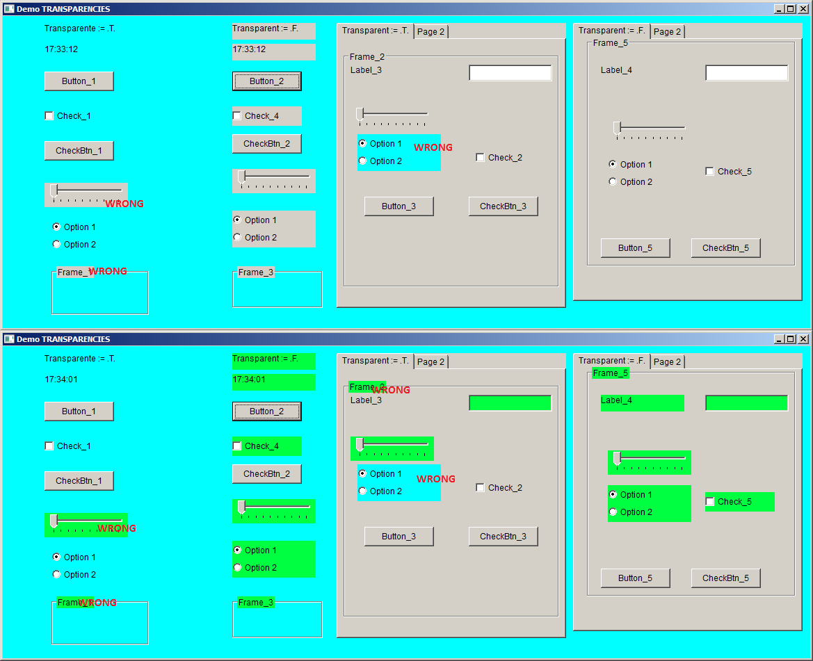

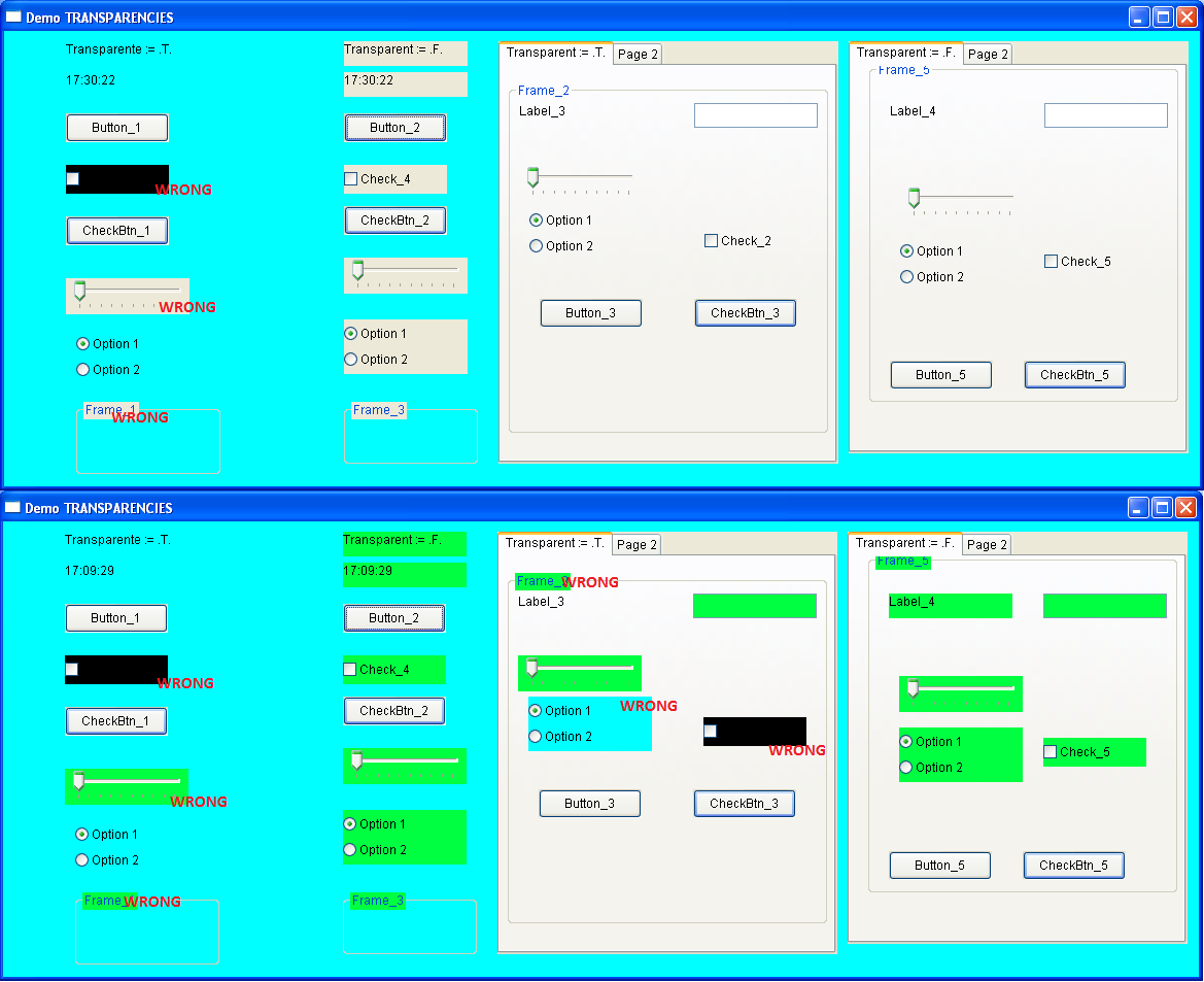

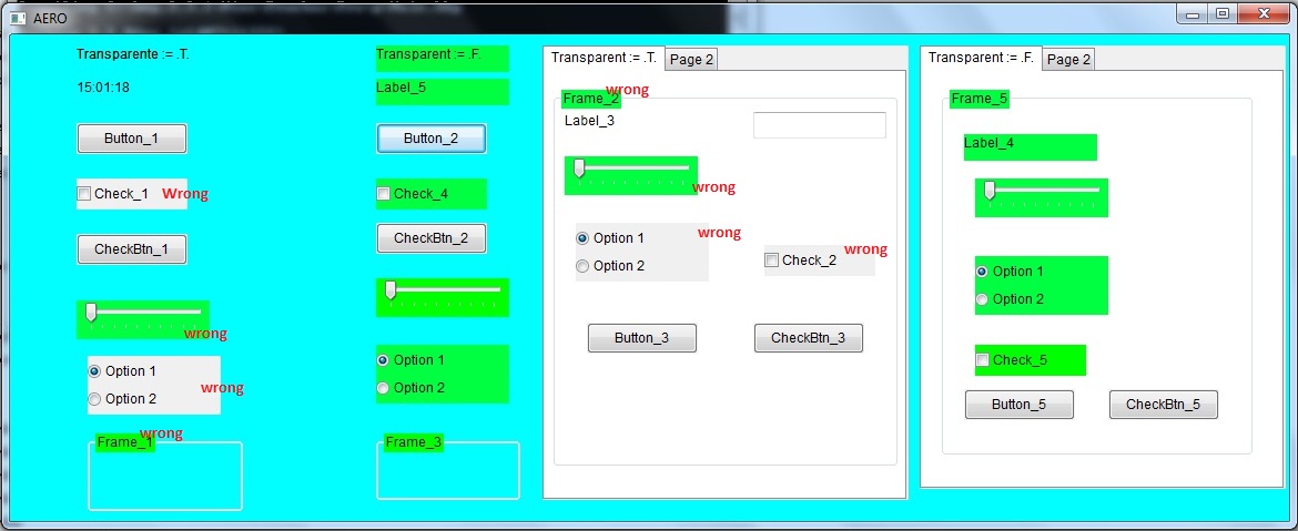

Hola Pablo César,
Así esta bien?, las imagenes hablan por si solas.
A los controles les puse BackColor de Verde (Claro que solo a los que se les puede poner) y el Form está en color ciano.
La Primer columna de controles tienen la propiedad de transparencia como .T.
La Segunda columna de controles tienen la propiedad de transparencia como .F.
Los Controles del Primer Tab tienen la propiedad de transparencia como .T.
Los Controles del Segundo Tab tienen la propiedad de transparencia como .F.
Resumiendo. Los Controles que no trabajan su propiedad de transparencia son:
  1. Windows Classic
    1. Slider
    2. Frame
    Cuando son contenidos en un Tab:
    1. Slider
    2. Frame
    3. RadioGroup
  2. Windows AERO
    1. CheckBox
    2. Slider
    3. RadioGroup
    4. Frame
    1. CheckBox
    2. Slider
    3. RadioGroup
    4. Frame
Saludos y Cualquier comentario es bienvenido.
Hi Pablo César,
Is it okay now ? Pictures speaks for itself.
Controls were put BackColor Green (Of course, only those who can put them) and Form is Cyan color.
The first column controls have the property of transparency as .T.
The second column controls have the property of transparency as .F.
First Tab Controls are the property of transparency as .T.
Second Tab Controls are the property of transparency as .F.
Briefly. Hereunder Controls which are not working transparency property:
  1. Windows Classic
    1. Slider
    2. Frame
    When at Tab:
    1. Slider
    2. Frame
    3. RadioGroup
  2. Windows AERO
    1. CheckBox
    2. Slider
    3. RadioGroup
    4. Frame
    When at Tab:
    1. CheckBox
    2. Slider
    3. RadioGroup
    4. Frame
Greetings and Any comments are welcome.

These is strange behavior, I even in classic mode, there are not working properly the transparency of some controls.
Transparent property not working properly
Hi Javier,
I do not know if you will agree, but IMHO removing BackColor in all controls helped a lot to identify errors easily and I made this summary and picture comparisons:
  1. Hereunder, tests been done in Windows 7
    1. For Classic mode:
    2. Sliders do not work Transparent at all ( always assumes with BackColor )
    3. Captions of Frames, Transparent never works ( always assumes with BackColor )
    4. When Transparent of RadioGroups inside of Tabs assumes Form BackColor, not assumes Tab BackColor as should be
      Remark: There is no BackColor in Tabs.
    1. For Aero mode:
    4. RadioGroups do not work Transparent ( assuming Nil BackColor )
    5. When Transparent of RadioGroups inside of Tabs assumes gray color or lets say Nil BackColor, not assumes Tab BackColor as should be
    6. When Transparent of CheckButtons inside of Tabs assumes gray color or lets say Nil BackColor, not assumes Tab BackColor as should be
  2. Hereunder, tests been done in Windows XP
    1. Sliders do not work Transparent at all ( always assumes with Black Color even define any other BackColor or even Nil BackColor ) :o
    2. Captions of Frames, Transparent never works ( always assumes with BackColor )
    3. When Transparent of RadioGroups inside of Tabs assumes Form BackColor, not assumes Tab BackColor as should be

I hope to be contributed to clarified in better way, of course with help of Javier. Thanks Javier !
So this is a pending matter, not replied from HMG Development Team. Please be so kind to comment it and observe "WRONG" tagged at some control on transparency deffect.
Thanks all for your attention,
B.Rgds
Re: Transparent property not working properly
Ok Pablo César, Esta bien!!!
