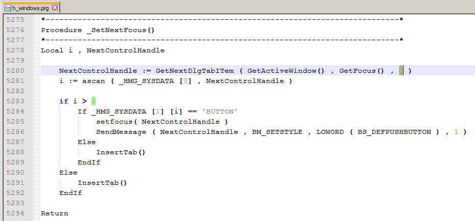

To our Development Team,
This _SetNextFocus() is usefull when we want to advance forward to the next item (like a TAB).
But I did not found any other function that could allow to advance backward to the previous item (like shift+tab).
I saw _SetNextFocus() uses the GetNextDlgTabItem C function.
Reading MSDN about it, says the 3rd parameter (logical type) is for next/back.
If you agree and believe would it be useful, we can use this same function:
Changing something like this one:
Procedure _SetNextFocus(lNext)
Local i , NextControlHandle
DEFAULT lNext := .T.
NextControlHandle := GetNextDlgTabITem ( GetActiveWindow() , GetFocus() , lNext )
i := ascan ( _HMG_SYSDATA [3] , NextControlHandle )
If i > 0
   If _HMG_SYSDATA [1] [i] == 'BUTTON'
      SetFocus( NextControlHandle )
      SendMessage ( NextControlHandle , BM_SETSTYLE , LOWORD ( BS_DEFPUSHBUTTON ) , 1 )
   Else
      If lNext
         InsertTab()
	  Else
	     InsertShiftTab()
	  Endif
   EndIf
Else
   If lNext
      InsertTab()
   Else
      InsertShiftTab()
   Endif
EndIf
Then this function will have more one finality. Useful when we need to move Next/Back of controls by arrows keys, for example.
What do you think Claudio ? Is it posible ?
