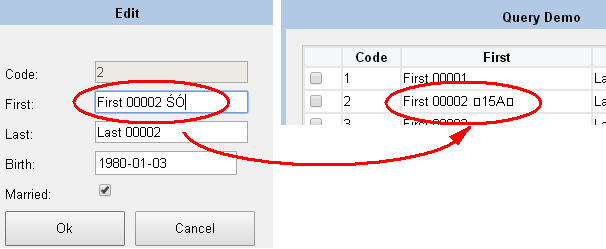

Re: HMGSCRIPT R39
For short: if I only can operate with unicode, then I can boldly call this release 1.00
XP+Chrome
XP+Chrome
- dbf_not_unicode_yet.PNG (10.19 KiB) Viewed 32618 times
- Roberto Lopez
- HMG Founder
- Posts: 4023
Re: HMGSCRIPT R39
How exactly you done this?Czarny_Pijar wrote:For short: if I only can operate with unicode, then I can boldly call this release 1.00
XP+Chrome
(I have almost not experience with unicode)
TIA.
