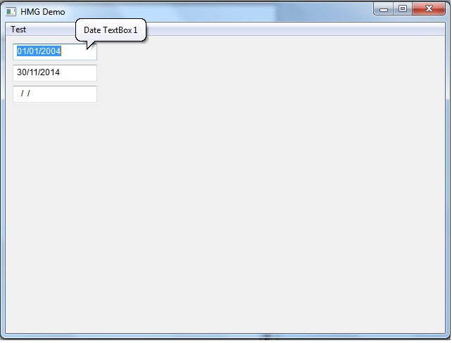

I tried in Win7 32 bits thru this code and worked for me normally.
May you test it in your Win7 at 64 bits ?
Also can you inform with HMG version are you using ? Unicode /ANSI ?

Please also note lines 51 and 52 and let us know if works for Win7-64bits. Because for me is working perfectly in Win7-32bits (thru SendMessage and also by SET TOOLTIPBACKCOLOR)
Javier Tovar wrote:Win7, 32 bits, HMG3.3.1 No trabaja, Unicode
Javier, puedes probarlo tambien ? Aqui a mi me funciona.
I guess this Tooltips doesn't take effects when your Windows has Appearance changed, for example AERO style doesn't work.
In my test, my Windows is setted default (not customed style, Classic one).

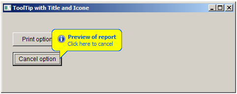

Estimado Claudio, todo indica que es algo a más que se debe ajustar para no sufrir interferencia del SO. Lo que pude leer es que existe la propiedad OwnerDraw, porque hé visto vários código que se utilizan asi como este y dá cierto:
http://www.codeproject.com/Articles/420 ... th-Image-C
Testeé este ejemplo y mismo personalizando la apariencia del Windows, funciona igual.
